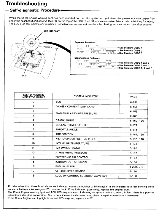

Old Apr 15, 2010 | 10:31 AM
You don't need a computer. You can pull the CEL codes:

ok i read the code and its the no. 1 cylinder position. what exactly does this mean. is meaning that the timing is off?
Old Apr 19, 2010 | 02:50 PM
Generally, you need to replace the distributor to fix this problem.

lol thanks alot man i had no idea it was that easy to read the codes. i just did my homework and figured out it was in the distributor and was coming back to post that i figured it out. thanks alot man!
