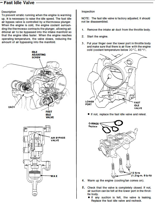

Also check and clean the Fast Idle Valve:

Default RE: weird reving
Sounds like it's your IACV (idle air control valve) or your fast idle valve. Clean them both with carb cleaner and see what happens.
