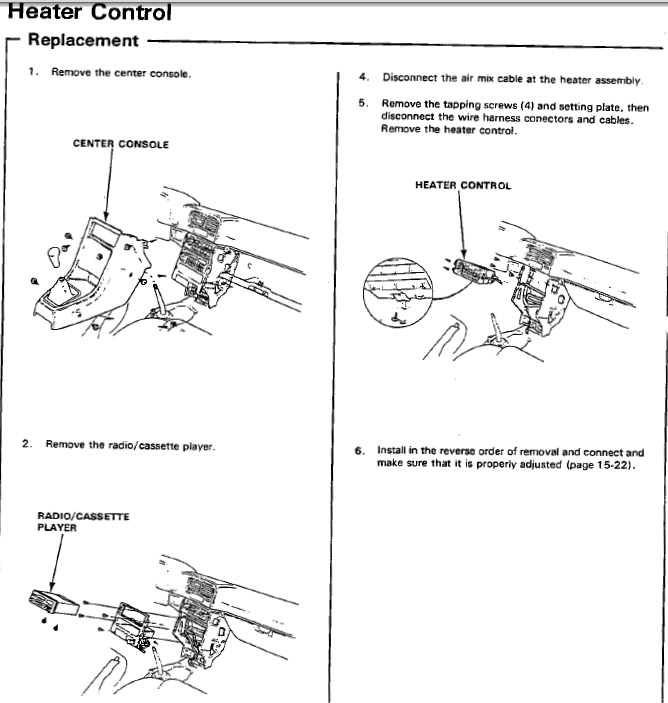

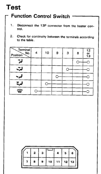

You may have a bad Function Control Switch. Here's how to access and test:
