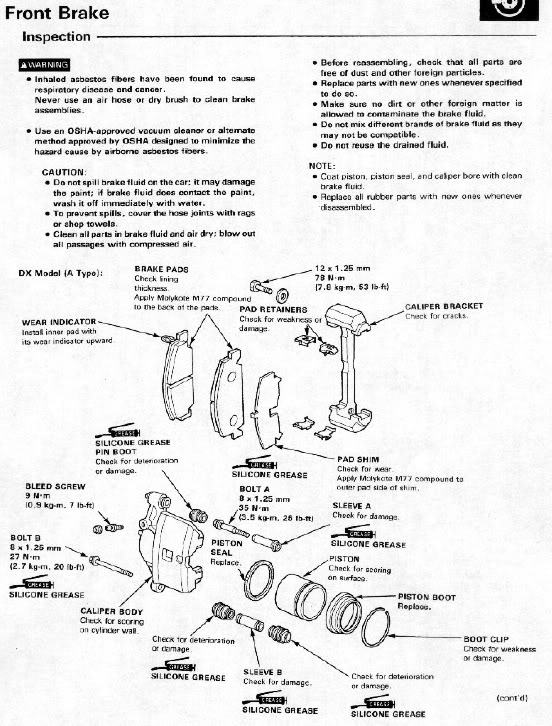

R&R'd the front pads and couldn't determine which one should go on the inside or outside. One has a squealer(for wear) on it and one not. Any ideas if the squealer goes inside or out. Thanks kevin

Inside

Thank You Sir. I had them in backwards. -K
