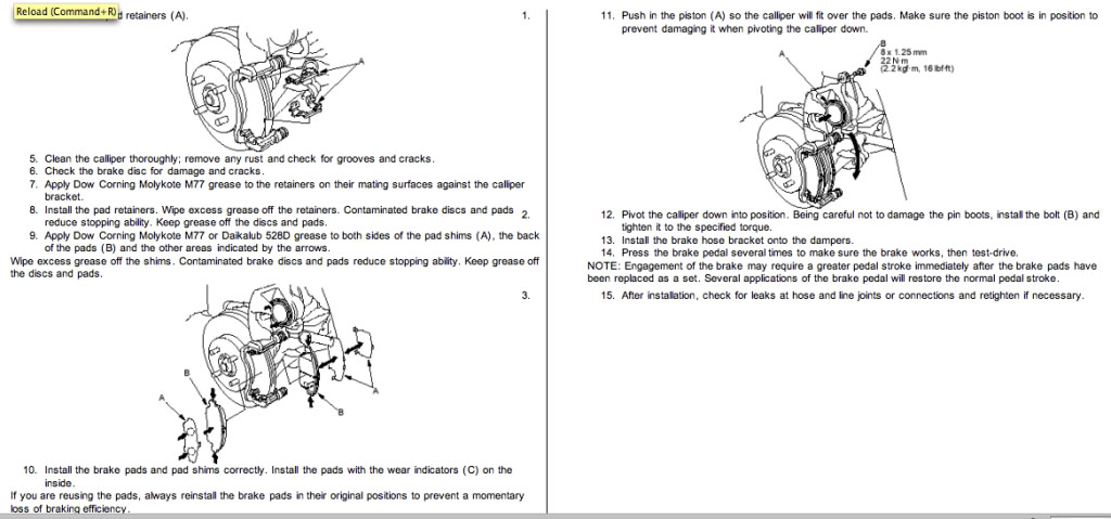

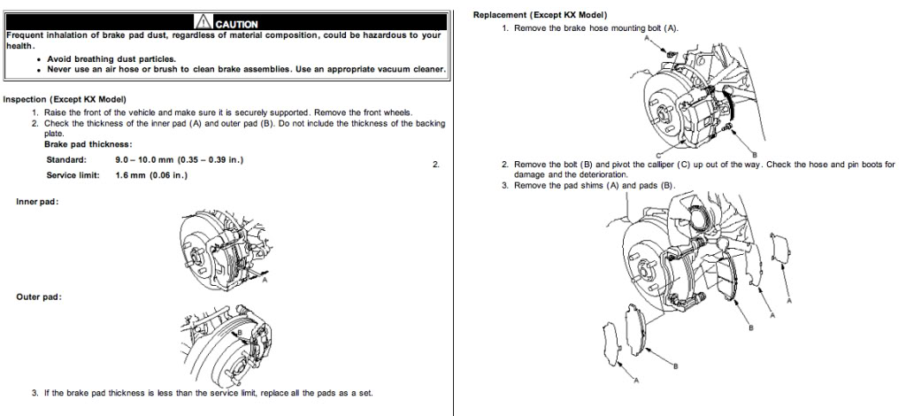

Obviously, you want to avoid paying dealership prices for a relatively simple job. Did you grease the retainers and shims?

nope, I did not grease anything.... thanks for the pictures
Old Nov 3, 2008 | 07:05 AM
When you finish greasing and re-installing the new pads, use brake cleaner to clean the rotor surfaces, which may have been inadvertently contaminated with grease from your hands. Similarly clean the brake pad surfaces prior to reinstalling them.

I did not find shims in there.... should there be? perhaps this is the issue?
Old Nov 3, 2008 | 07:29 AM
You should have shims. Sometimes they come with new pads. Purchase new ones if necessary. Also use the diagrams to verify that you reassembled the brakes properly.
