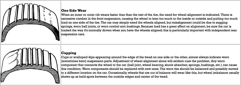

Originally Posted by Enance
As I was painting my rims the other day I had all 4 rims off. The aft left hand side tire was worn down on the inside tread. So im looking to see why the tread is wearing like that (the tire was practically new yet it was bald on the inside) Now Im not to good with technical names so bare with me... The whole assembly that the rim bolts on (rotor, axle, etc) was not aligned correctly, maybe. It is slightly slanted with the top to the inside and the bottom going outside. What I dont know is where to start to try and fix it. Is it the springs or struts? or do I just need to find a junkyard with a civic like mine and take the part. Someone told me that it could be some kind of adjuster since the rims I have now are 17 in and the factory were probably 15 or 16 it maybe be out of line for that but none of the other tires are, plus I do not see any way to adjust it. Any help will be greatly appreciated I can take pictures if that would be easier. Thanks.

need to have it aligned. your camber could be off, or toe is way off. when i put my full Skunk2 coil over kit on my 93 coupe, i lowered it about 1.5". then i put it on the alignment rack (i'm a chrysler/jeep tech) put 200lbs in drivers seat to match my weight so it's at ride height while doing the alignmnet. i put front and rear Skunk2 camber adjustment kits on as well. the alignment turned out perfect!! i haven't had an issue with tire wear at all and it handle's like a dream! if you can find a shop that will do the alignment with you in the car that would be the best!! i live in arizona, let me know if i can help....
