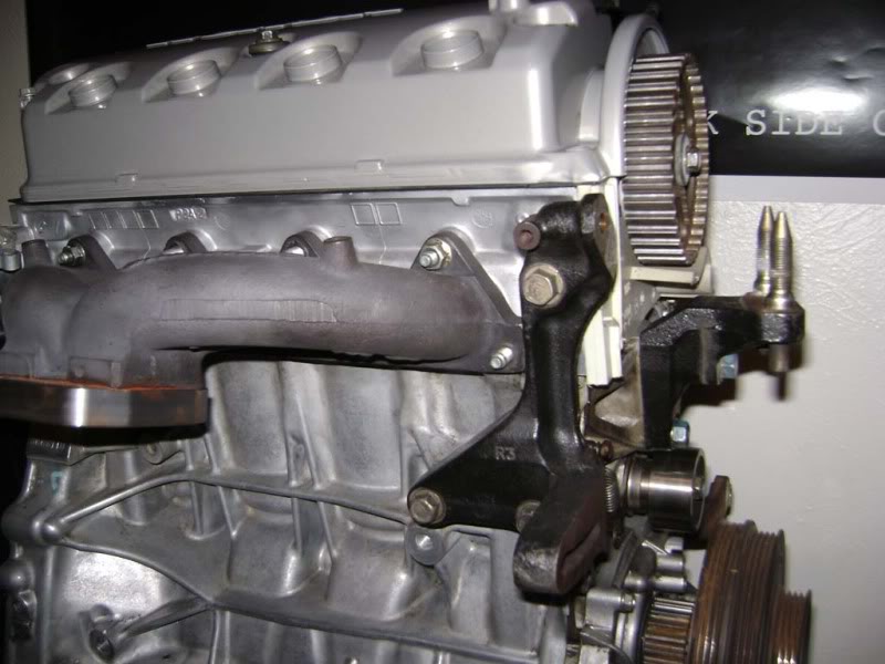

Old May 7, 2010 | 09:40 AM
  #720
My room is tough to photograph. The valve cover is Titanium Gold, but the flash overpowers. Without flash, it's too dark to see.
I've still gotta re-polish the letters so there'll be a pic of that if I ever have time to mod Hondas again.
