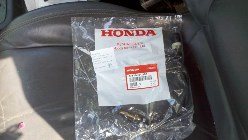

This will solve some problems. y8 throttle cable! I didn't have the bracket so I attached it to the cruise control bracket and just let that cable connect by the brake booster hose on that other bracket thing.
Now I need to drain some transmission fluid and fix the intake and I'm set.
