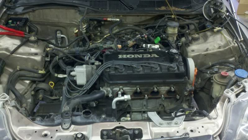

The IACV and/or TPS were bad. Switched back to my known good one from the old engine and it ran fine. The guy who helped me swap it in is gonna come by later today and we're gonna reset the valve lash. (It's AWFUL right now. TAPTAPTAPTAPTAPTAPTAPTAP.) I'm not happy with the throttle cable. I think I was sold a "y8" cable that was actually a y7 one. The cable didn't look that much different from what I had. They seemed the same length. Can someone with a y8 take a picture of that corner of the engine bay so I can see how the throttle cable is routed?
Here are a few random pictures from the process...

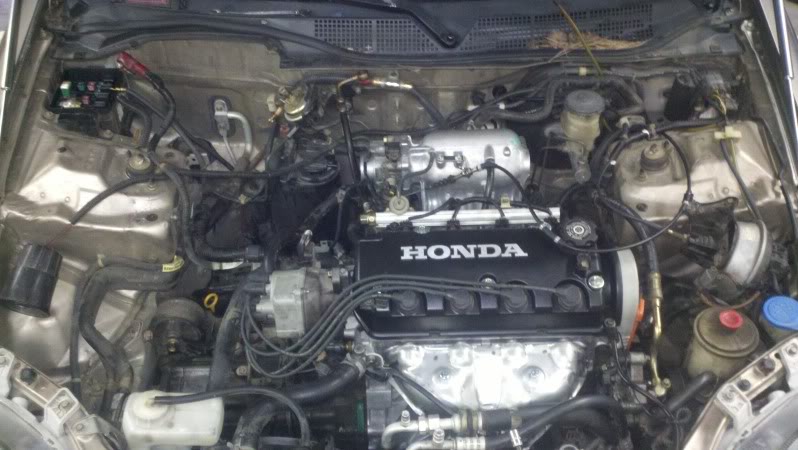

Old one almost ready to come out:

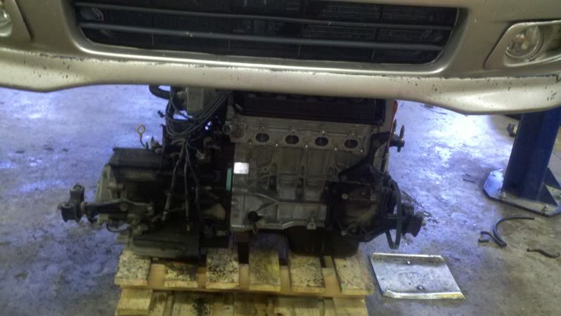

Out on a pallet:

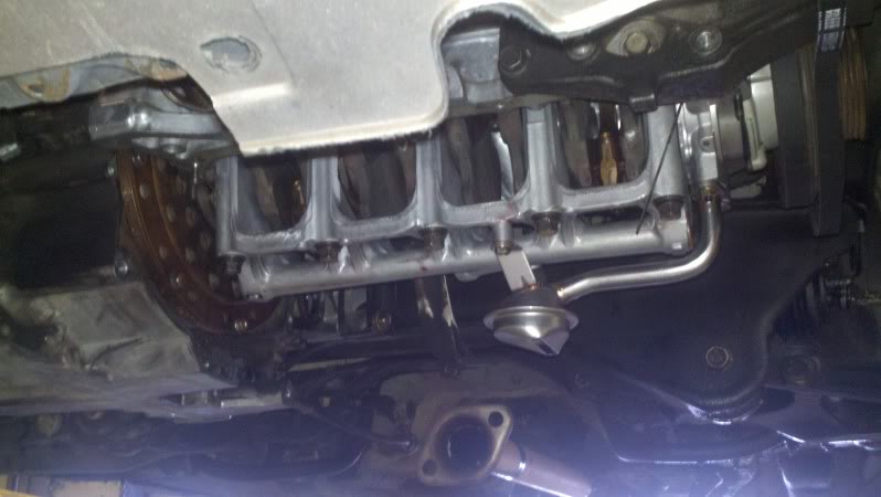

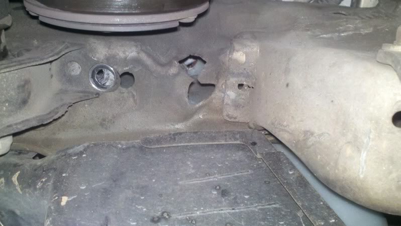

Check out the hole in my frame, lol:

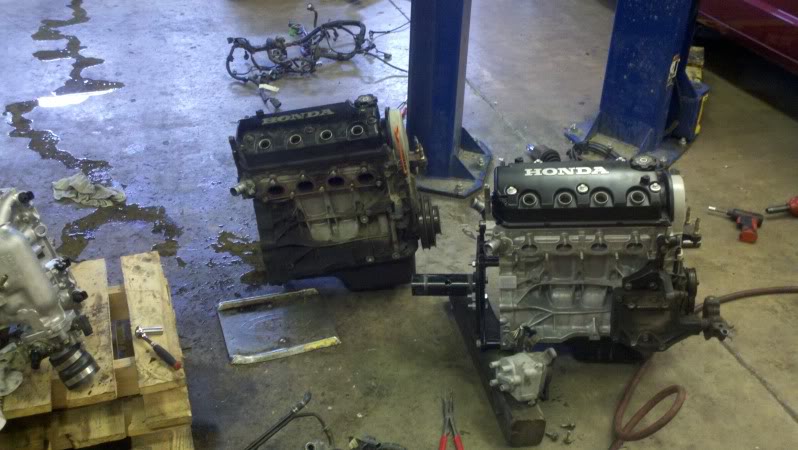

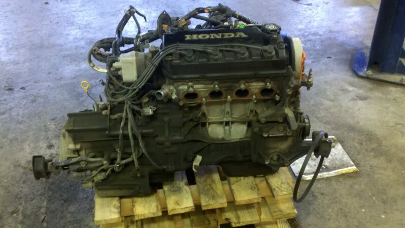

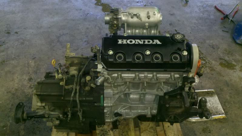

Old and busted, plus new hotness.

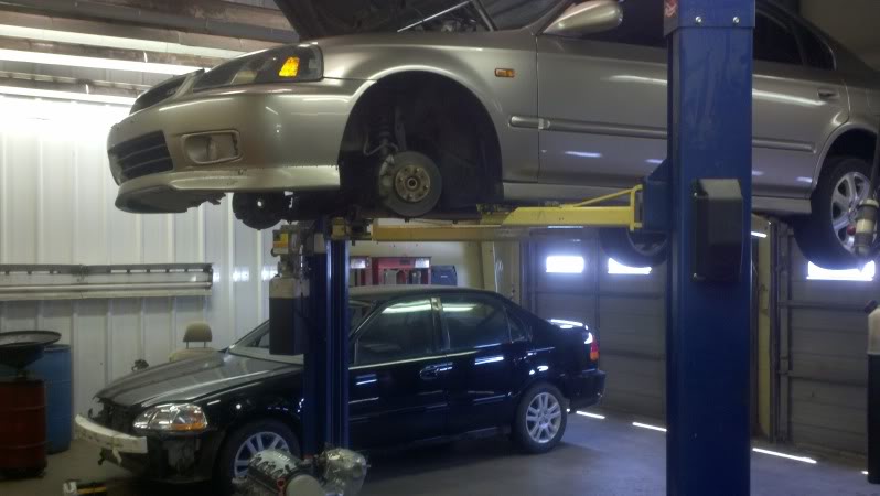

Hanging up high, beside the other Civic with a SUPER FRESH paint job:

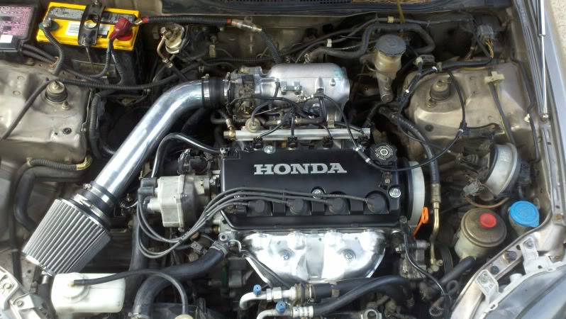

Finished product:
