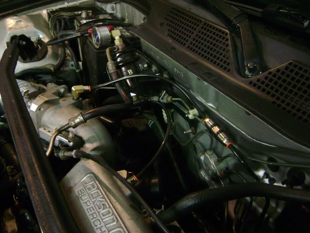

Lines running for the Meth nozzle (on the S pipe - will be moved), and the boost pressure sensor (is now actually just going to my MAP sensor instead):

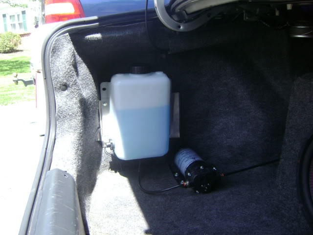

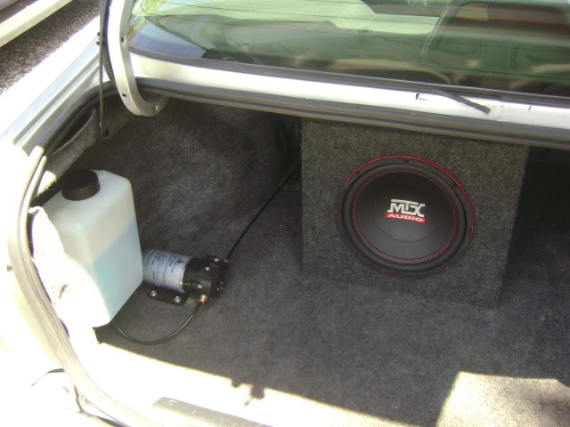

Where the stuff is in my trunk:

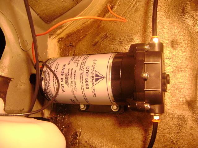

Pump:

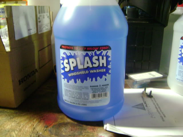

And my Meth!

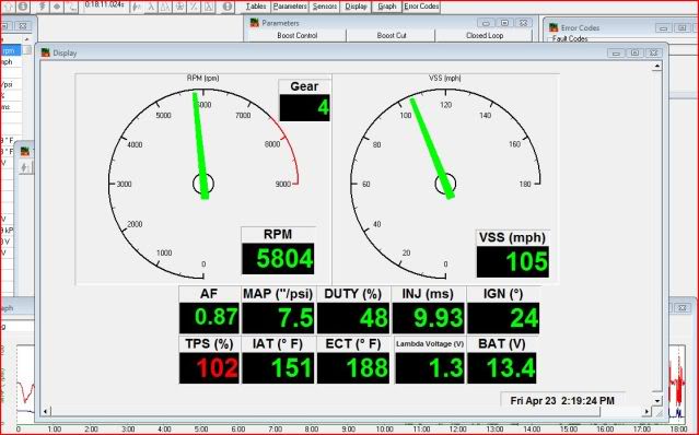

Power to the Meth kit was cut last night since it was late and we were in the middle of setting it up in the s300's menu, so I was able to go out and get a couple pulls in during the day to have a "before" meth IATs screenshot:
Ambient Temps were about 73 degrees F
Finishing up with the Meth install tonight (with the exception of changing the mounting point for the nozzle), and I will post up an "after" screenshot to show differences.

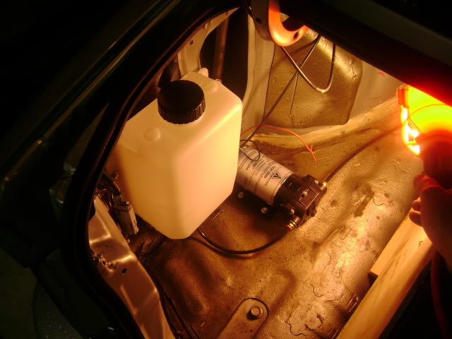

Update: we are having a bit of an issue with the s300 and it not switching the ground to activate the pump. Grrrr
Progress from last night - Cut up trunk lining and floor in order to fit the pump/tank nicely.... currently, this is what it looks like...

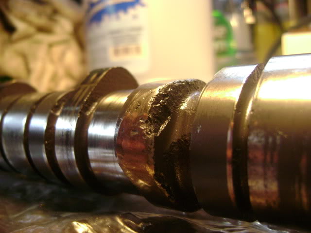

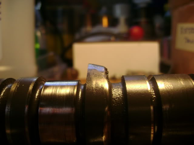

Oh yea.... I have been meaning to post these, so here ya go.

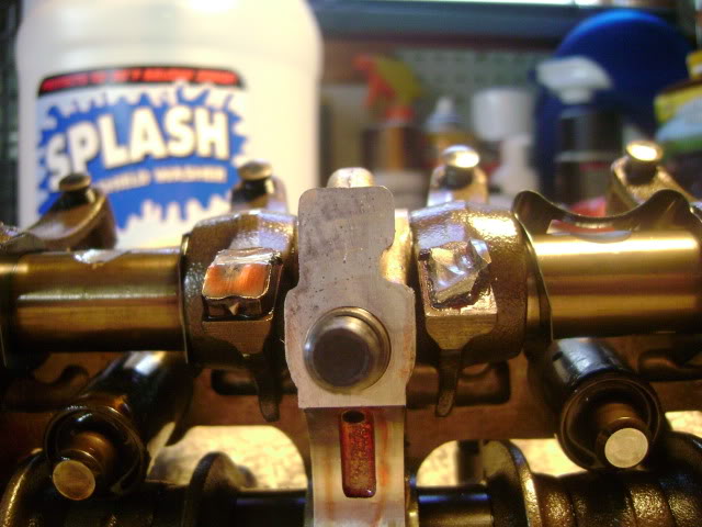

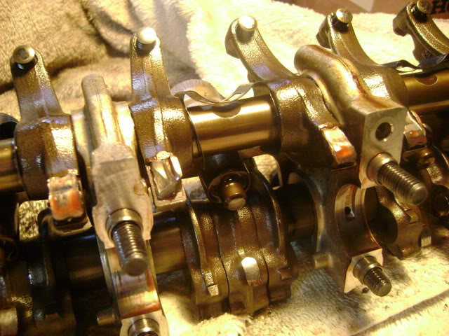

Rocker arm damage:
(obviously, you should be able to tell what's all F-ed from that picture)
With that damage, the camshaft had a fun time rubbing against it. Here's the camshaft:
Cool, huh?
I will be emailing Bisimoto about it this weekend. Hopefully, I can get another one at a discounted price, but... I doubt that would happen. We will have to see.
