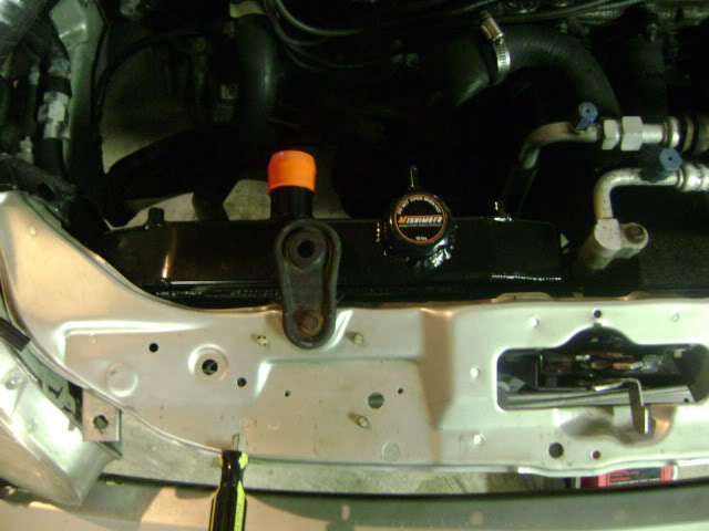

Pic of the black Mishi radiator (it is now installed 100% of course):

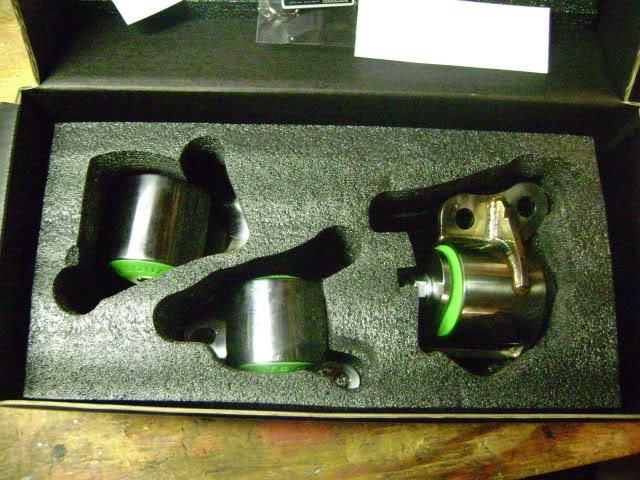

Mounts are in!

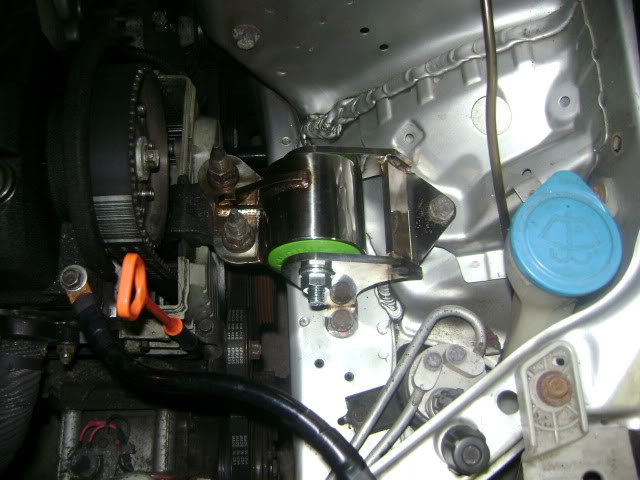

Driver's side:

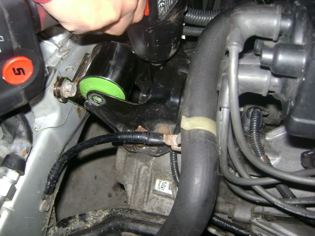

Pass/Trans. side:

The radiator/fan combo works great! No overheats even after sitting in one spot, idling for over 1 1/2 hours.
The mounts are not as bad as people would assume. They are 75A. Yes, you can feel more vibrations when starting off in 1st/2nd (whichever the situation calls for of course), but sitting at idle, there's only a slight difference. My torque mounts were filled solid with polyurethane a few months ago, and those are what transfers vibrations most.
Shifting is a lot easier/precise, the motor responds quicker (due to less movement) when I slam on the gas, and they look pretty IMO
Link to the set of mounts I bought in case anyone wanted to see them
