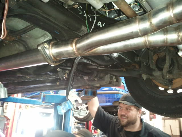

Pic showing the cables going into the car and the new "test pipe" which was made.

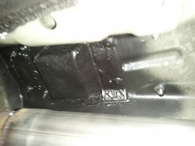

Pic showing the underside of the shifter. The shop ended up making the necessary cut, but took it a step further.
They ended up pop riveting a "shield" to prevent anything from getting kicked up there and undercoating it. Love it.
