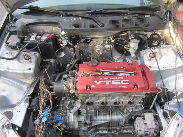

No progress on the motor swap. The wiring is becoming a complete nightmare. I am lost on a few things, and I do not want to take the time to extend wires and whatnot, put everything together and then have something be wrong and me having to pull everything off again to fix it. I am in the process of looking at the wiring harness in the FSM I just downloaded and matching the wires and plugs with where they need to go using the 92-96 Prelude FSM.

On your wiring,
Just remember that the Knock and injector wires are shielded, rewire from pin to pin with shielded wire if they need to be longer.
On mine they just spliced in non shielded wire and I need to rewire the injectors.

On your wiring,
I am not using the knock sensor. The ECU (P28) I have does not support it. The injector wiring has already been handled. I am getting confused in regards to the sensors under the distributor (on the head) and on the transmission basically. That whole area is what is taking so long. Everything else is basically done and ready to go I believe.

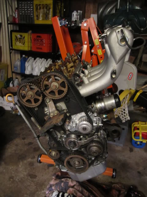

Skunk2 IM installed. I wish I could use this. It is sooo nice looking!

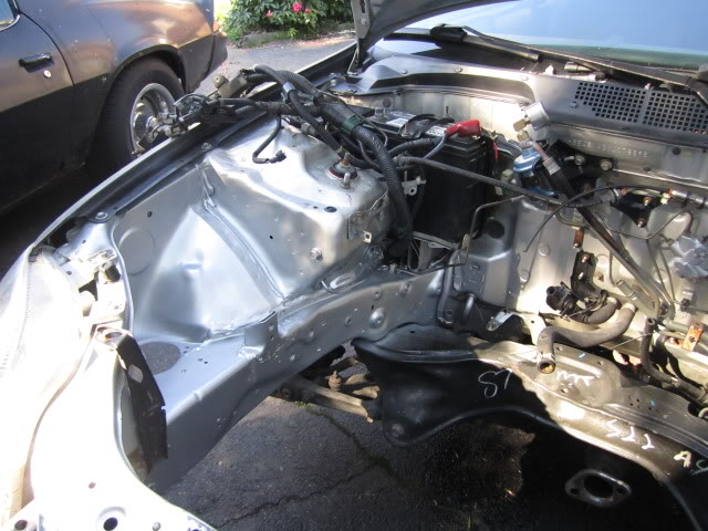

Passenger side bracket welded. I am being told by a few H22 people I know that this is a weak point in EK's with H swaps:

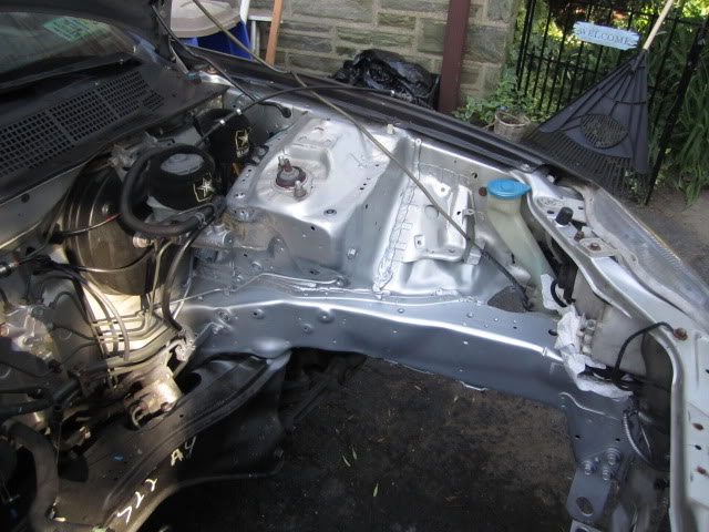

All cleaned up and frame rails re-sprayed. I will finish the rest later when I have extra time to mask things off etc.

Basically current pics (except of the header) and the wiring mess:

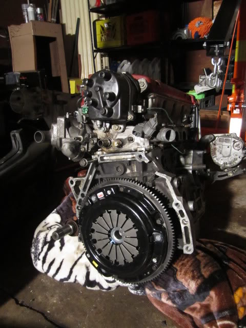

CC Clutch:

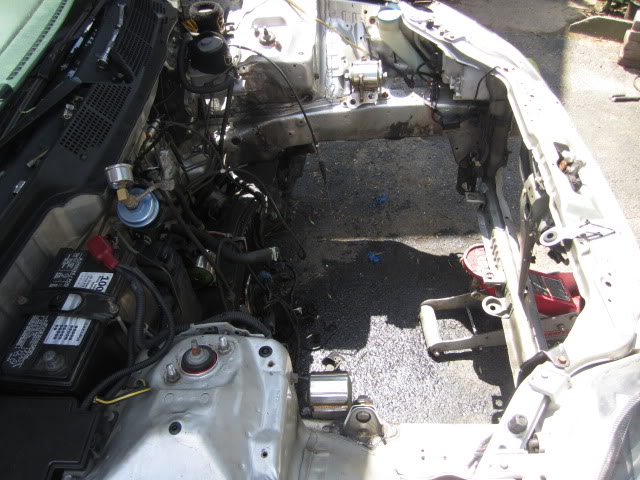

Engine bay (empty and uncleaned):

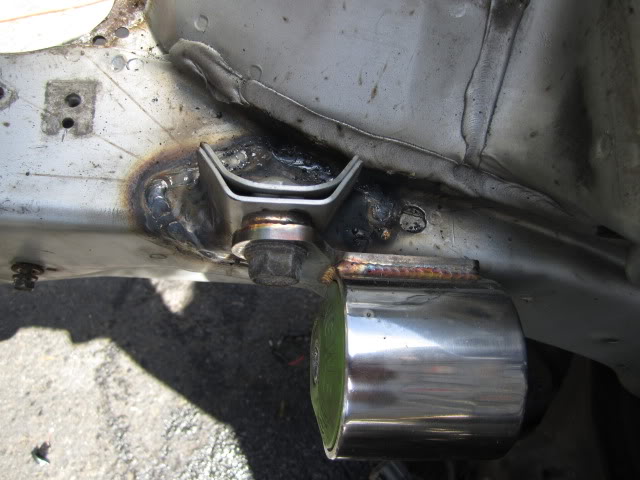

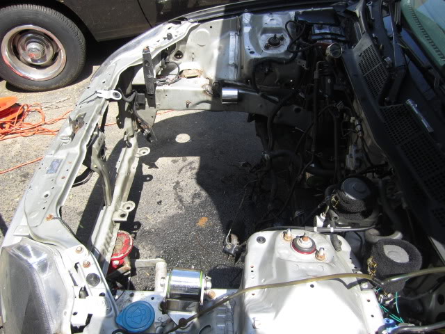

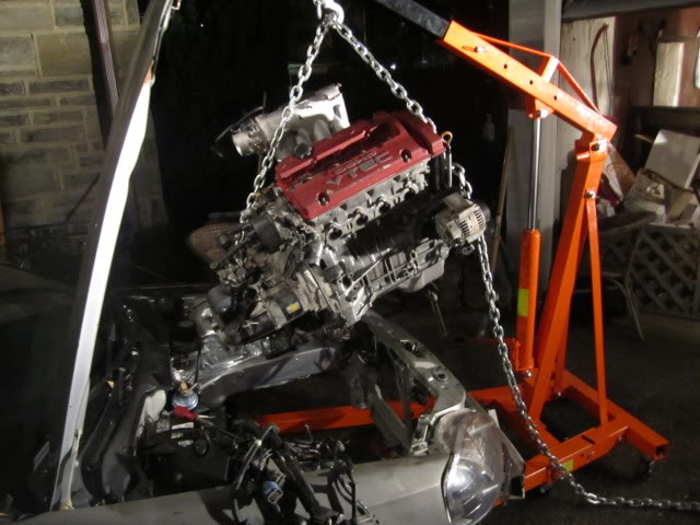

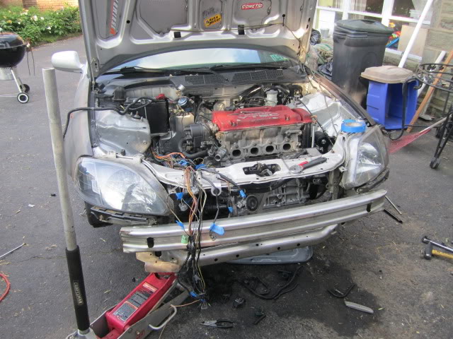

Motor going in! We only did this for pics. I ended up installing the motor from underneath and lowering the car on it.
