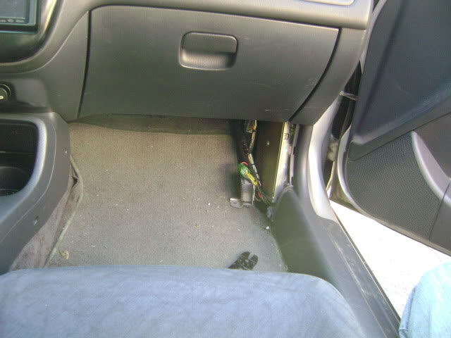

Ok, stock harness is basically out. This install should be fairly simply tomorrow afternoon. I was able to match up all the needed plugs. Just have to pull out the battery tray and pull the wires through.
Pics tomorrow showing the Rywire vs. the stock harness along with installed pics of the harness etc.

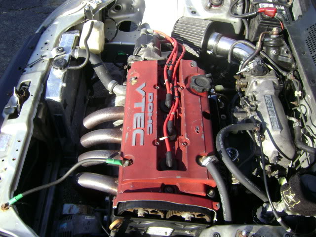

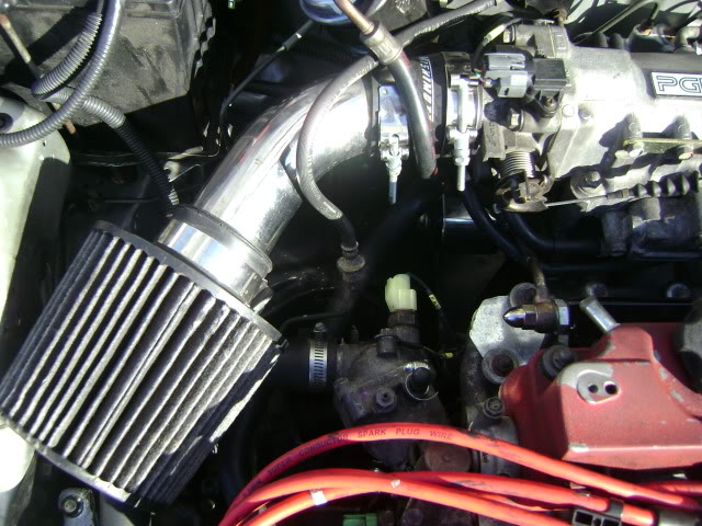

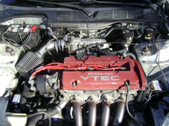

Ugly harness out
Updated engine bay pics.

Finally, the ECU is bolted back into place!
I am happy to say that everything is working perfectly. Car is running better than ever, zero CELs, and no hesitation throughout the power band. Even better, my VSS is functioning now so my speedo and odometer work again!
